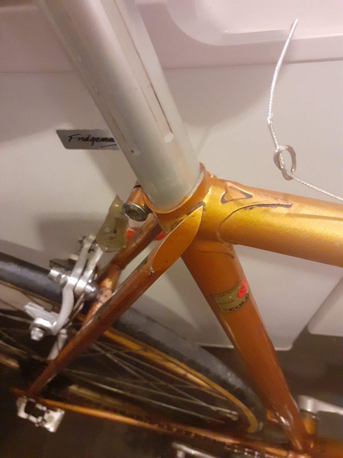

Hi, thank you for posting this I formation about the wolber spidel cycling team.
I'm positive it's a team wolber road bike but would like to know what you think.
The reference number on the bottom bracket is 030383.There is also a another number 57 stamped above..I think this might relate to the frame size.i have checked the frame size and it is 56cm centre to top.
I think it might have originally belonged to Graham Jones who rode for wolber in 1983.the bike was bought in northern England in 1988.
Any input would be greatly appreciated.
Cheers

Good Morning!
Great to hear from you. :) This is indeed a team bike of the Wolber-Spidel team. It is also the original color, right? I have to research a bit again and look through the fotos. Maybe @puntom can help you, he is very much into that time and history. Are there any markings or letters on the top or seat tube? Marc Gomez told me that mostly the name or the initials were written on the frame with a pen.
57 is for sure the frame size...
Great found!!! :)
Did the pre-owner knew a bit more about the background? The frame was one of the lightest I ever hold in my hands...preserve that treasure. :)
You probably saw that picture already on Classical Lightweights right? The frame of Graham Jones could be something like 57ct. Marc Gomez had the same size. :)
030383 = 03.03.1983?

hi,
Thank you for getting back to me with this information and cool photo...it looks like the right size!.
All decals have been removed and no indication to i.d. the rider.do you know what the first two numbers 03 03 83 might mean?..
Iam going to get in touch with the people i bought it from today for a bit more info....they did say it was from an ex professional who was selling it around 1988.i think they mentioned Manchester.
tcheers,

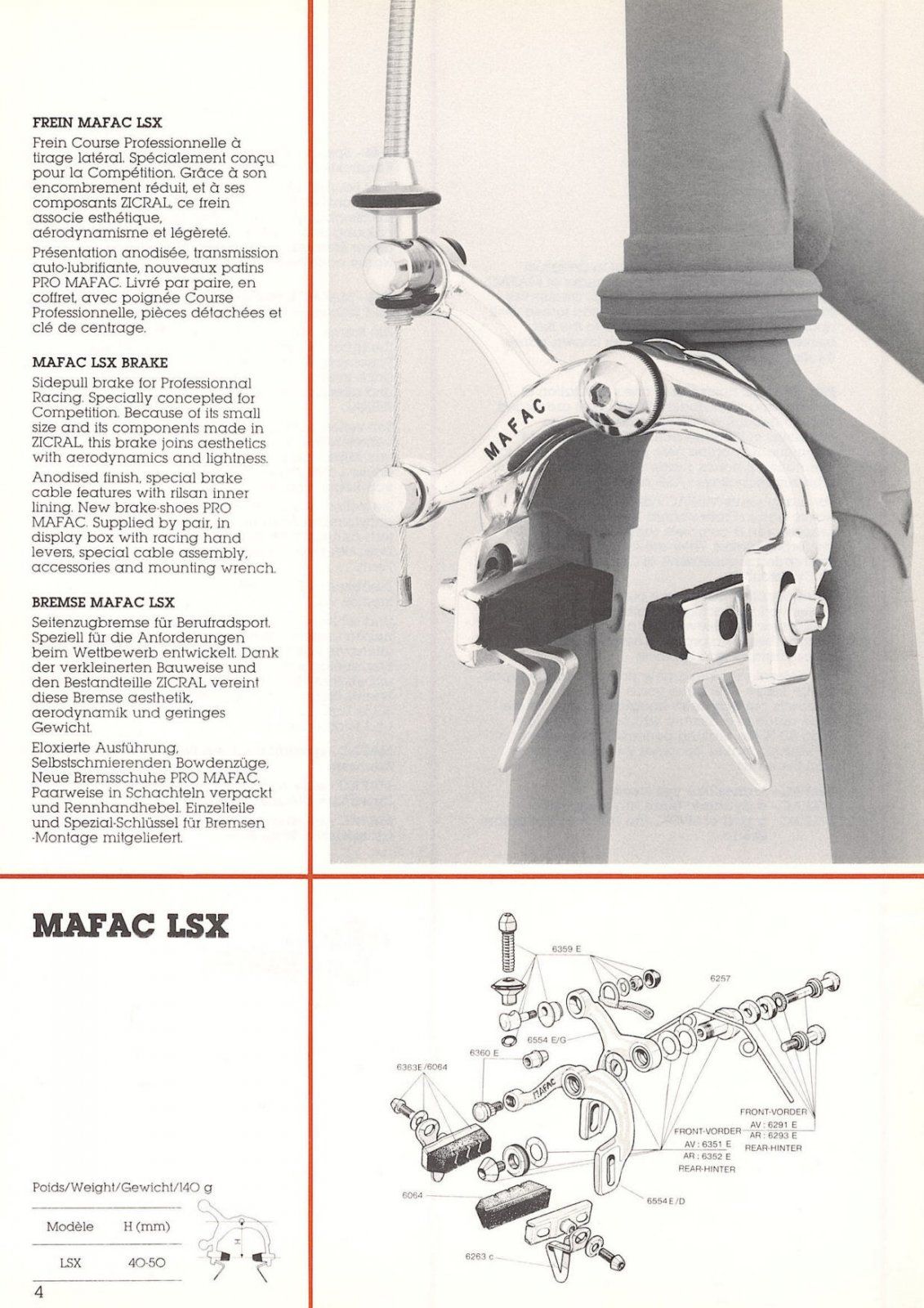

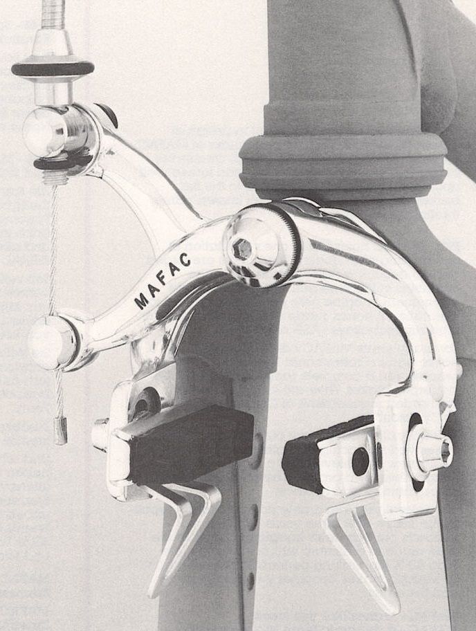

Ein weiteres interessantes Detail ist übrigens, dass auf den Bildern die Bremsen gut erkennbar sind. Es sind Mafac/Spidel LS2. Diese haben aber immer eigentlich silberne Einführhilfen an den Bremsschuhen
und diese Pfeile. Auf dem Bild sind jedoch schwarz gummierte Einführhilfen erkennbar:
Abseits der gummierten Einführhilfen, ist auch ein Bremszugeinsteller erkennbar, wie bei den ➡🔜
MAFAC LSX
http://velobase.com/ViewComponent.aspx?ID=17743BDD-25FA-4CC0-A5D0-F4031C296ED3&Enum=117&AbsPos=0seit 2015 auf velobase.

Great!!! Keep us updated, for me it looks like the original color. :)
I think the framenumber is the date of the production day-month-year. Would also fit to your time frame right? 3rd. of March 1983. :)
Greets!

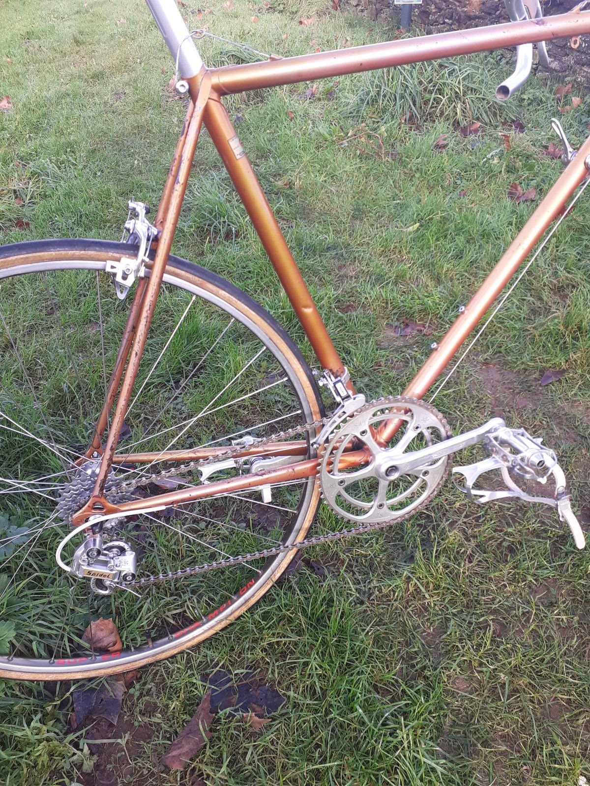

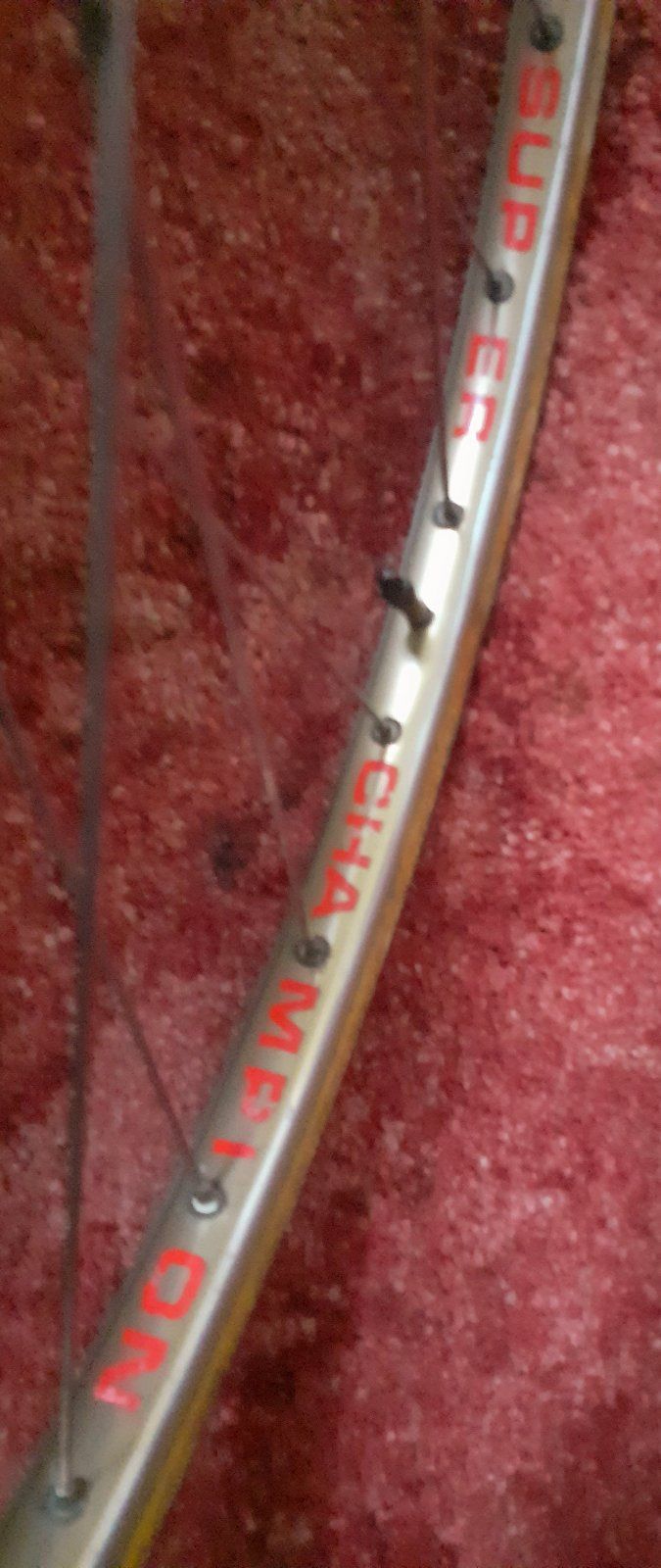

The wheels are Wolber super champion 32 spoke rims on Spidel/Maillard 700 heliomatic hubs.have added a picture.
Regards,
James
Ps.I raced in Ireland throughout the 1980's and remember kelly and Roche well...great memories.The black and white photo is me ,at the front in the 1984 tour of ireland.Moved to UK in 1988 and have been here since..thinking of heading back now due to B....t!.
Regards,
James
The wheels on my bike are exactly the same. Would love to have the decals too, so I can start the restauration. Nice find with the picture of the dent. Best regards and a happy new year!
