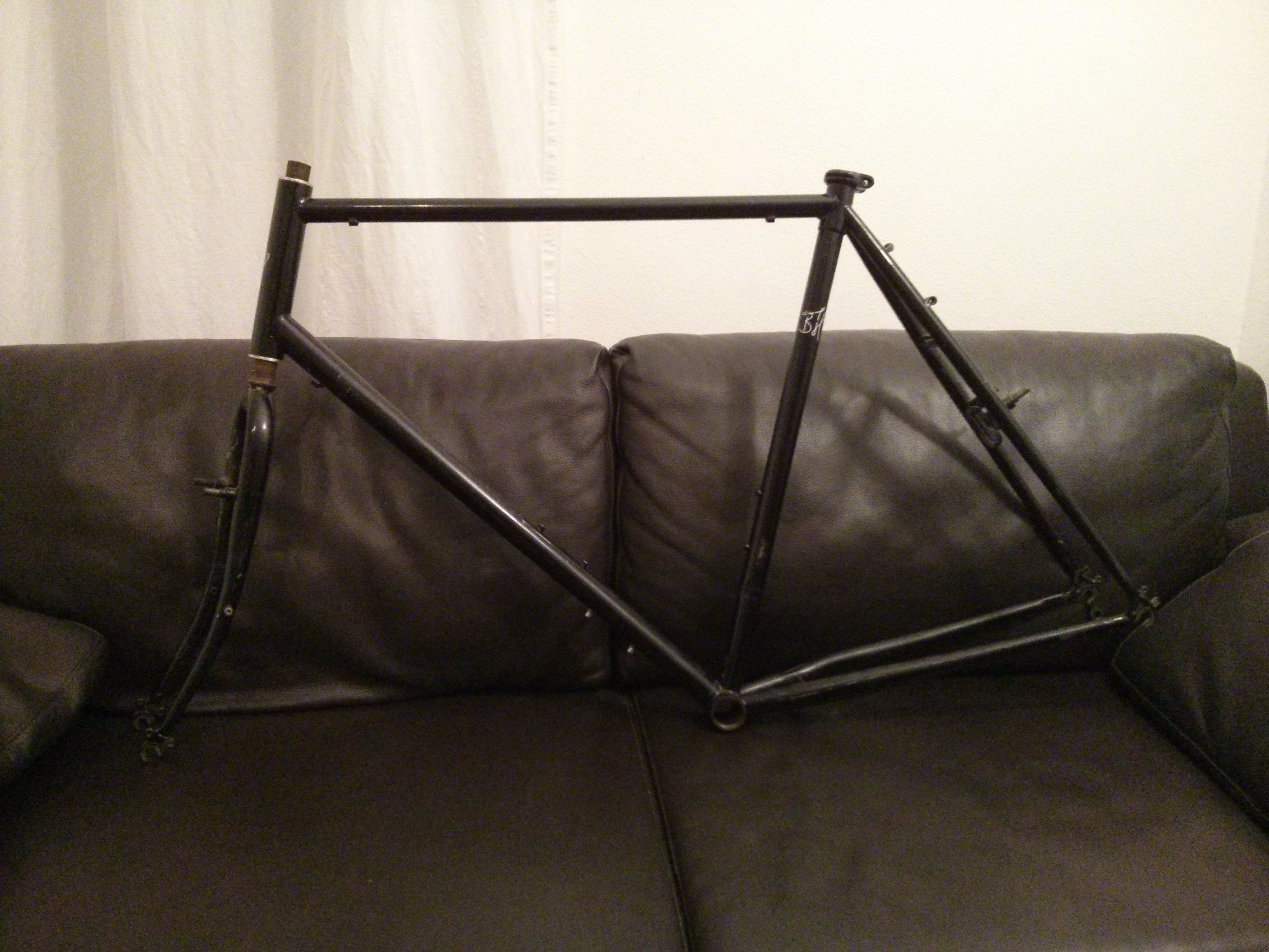

Aufbau: Herkelmann Randonneur

img_20170611_221428-jpg.458453
