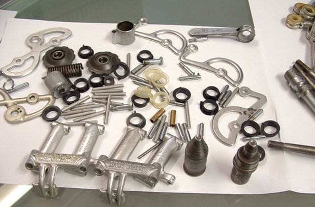

"I believe I have 'fair dinkum' busted open the mythology surrounding unusually dated Campy rear derailleurs.
We have all seen the 2nd generation SR units dated pre 1979 and NR units with 1st generation SR plates. Were these secret prototypes that originated from the development bunker under Campagnolo HQ? The prices that have been paid would led you to expect as much......
Now my little tale....
I recently received a package from a close friend who lives in northern Italy and it consisted of about a kilogram of small rear derailleur parts and a Campagnolo stamped hand held punch set. The parts are a mix of NR, SR1st and 2nd gen components. My friend lived in a town close to the Campy factory, went to school with the children of Campagnolo employees and played with them out of school. It was common practice, and knowledge for some employees to take small components from the factory and make up rear derailleurs at home in the evening as a 'sideline'. The village barber, an ex pro racer, had a glass showcase in his shop where he not only displayed these but sold them as well.
When you think about it, what perfect sense this makes. So much easier to stuff into your pocket than a crankset - and a reasonably high value item to boot. I would say that there would be a lot of BB sets and headsets out there as well that never had boxes. These guys would not be a pedantic as us about dates and the details we agonise over....just get it together and make it work! I imagine that the 'blue collar' Campy workers of the '70s were only on basic wages and stock control would have been fairly elastic. Obviously Campagnolo Pty Ltd would have done something about this had they known, and this problem of staff theft is still one of the largest security issues that exists in modern business.
I'm glad I didn't invest in a funky collection of mismatching rears when the urge began to take hold a while back...now I can make my own! "
"Ich glaube ich habe zweifelsohne den Mythos, der um die ungewöhnlichen Campa Schaltwerke kreiste, geknackt.
Wir haben alle die 2.Generation SR Einheiten mit PAT Nummern von vor 1979 und NR Einheiten der 1.Gen. mit SR Schildern gesehen. Entstammen diese geheimen Prototypen aus dem Campa Bunker unter dem Campa HQ? Das Geld das für solche Einheiten bezahlt wurde und wird lässt darauf schließen...
Nun meine kleine Geschichte:
Kürzlich bekam ich ein Paket von einem guten Freund aus Norditalien, es wiegt über 1KG, voll mit Kleinteilen von Schaltwerken und einem Campa Nieten Stempel Set.
Die Teile sind ein Mix aus NR,SR#1 und #2 Serie. Mein Freund lebte in einer Stadt nahe der Fabrik, ging mit den Kindern der Angestellten zur Schule und spielte mir ihnen.
Es war für manche Angestellte üblich sich Kleinteile mit nach Hause zu nehmen und dann abends in Heimarbeit eigene Schaltwerke herzustellen, als Nebenverdienst.
Der Dorf Friseur, ein Ex-Profi, hatte eine Glasvitrine in seinem Laden, wo er diese nicht nur ausstellte, sonder auch verkaufte.
Wenn man darüber nachdenkt, macht das alles ziemlichen Sinn. Es ist viel einfacher so etwas in die Tasche zu stecken als eine Kurbelgarnitur und zudem ein ebenso wertvolles Stück.
Es zirkulierten sicher auch einen Menge Steuersätze und Innenlager die nie eine Verpackung hatten.
Diese Leute waren sicher nicht so genau und haben sich den Kopf zermatert über Baujahre und Details...Hauptsache es passt zusammen und funktionierte.
Ich stelle mir die Blaumänner aus den Campa Werken der 70ziger vor, mit ihren durchschnittlichen Gehältern und einer lockeren Kontrolle in den Lagern (und Produktionslinien a.d.R.)
Sicherlich hätte Campa Pty Ltd etwas dagegen getan, hätten sie es gewusst, und Diebstahl ist auch heute noch etc.pp......Ich bin echt happy nicht mein ganzes Geld in "fehldrucke" investiert zu haben als das Verlangen danach groß war. Jetzt kann ich mir meinen eigenen Bauen."
