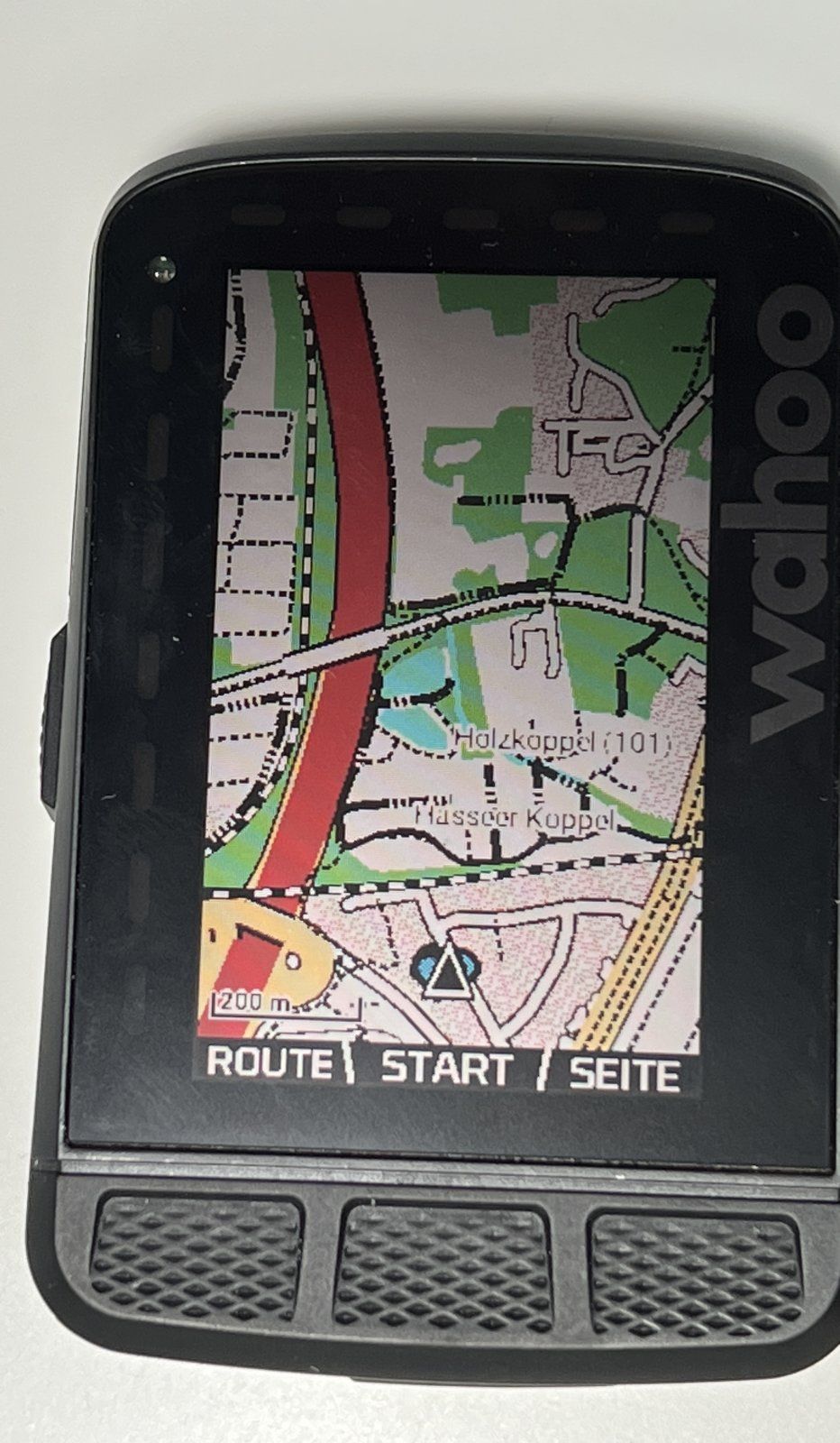

Quick Test: it works!!! Thanks Erwin……. but now my green is gone 🤣. No Forrest …

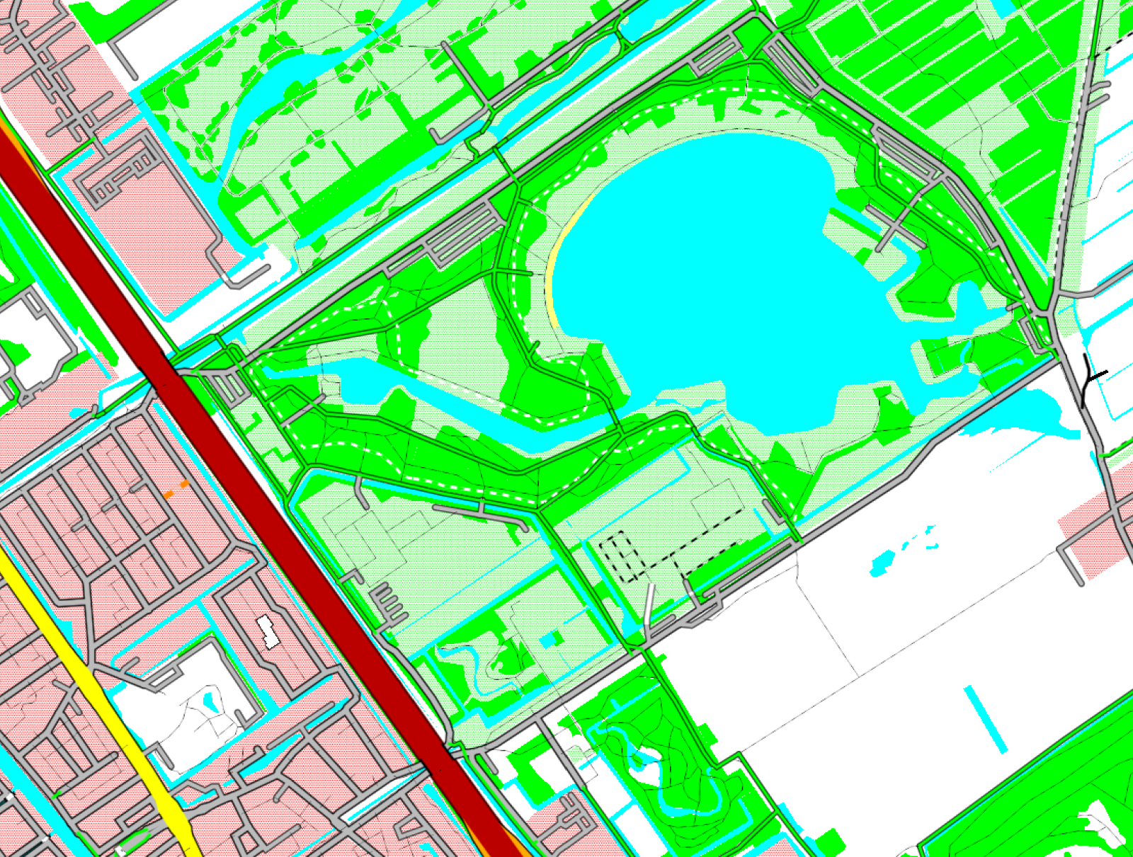

Lol, at least partly successful then! I will have a look tomorrow but this is not something I made. This part of the theme is originally from Wahoo and Zenziwerken (and possibly others). Most obvious reasons for it to not work would be missing pattern file on your device, than wrong color green used in the pattern image file. Maybe best and simplest solution would be to use the bolt_2 solid green setting. If you saw green before it obviously is a valid roam1 color. @treee111 , this also means the Zenziwerken theme on your git page in all likelihood will have the same device detection problem...
@Mikle_01 It seems that the pattern file does indeed use the wrong color. Not being a "graphical" person it took some time to change it. Could you please FIRST try to replace just the light_green.png on your device with the one from the hidrive Forced Roam1 sample theme folder here HiDrive link. That should make all stuff that was green before and the new green added be displayed as the pattern green.
After that could you try to overwrite the themes xml file on the device with the one from the HiDrive? Hopefully it will make park's and nature reserves use the pattern file and forest be a solid green. Looking something like this, a park with "forest" area's in it:

ok...I've replacing the light_green.png. Wich theme(s) xml file do you mean!? the vtm-elemnt.xml here from the HiDrive-Sample vtm-elemnt theme or HiDrive-Sample vtm-element-forced-Roam1 theme !? 🤪
Edit: Took the forcedRoam1 XML and it looks good; urban red and forest/park green! Thanks for your great effort and work!

Nice! Sorry but thought which xml would be clear given the hidrive link.
Did you try first with just the new pattern file before overwriting the xml? Because in your screenshot I don't seem to see any green pattern. Could be there just are no parks there but would like to verify the pattern file is good.

No sorry - made both changes simultaneously 🤣…. But now I’m really satisfied! Made a short gravel Tour - best Test for this Setup and new Settings… Really glad now! Also urban style in red is working. In my opinion there are only two different shades of green; solid and semitransparent. Look at my pics. But hey… after 3 Years with my Roam1 I feel I have a new device 🍀👍🏻 🥰😂
