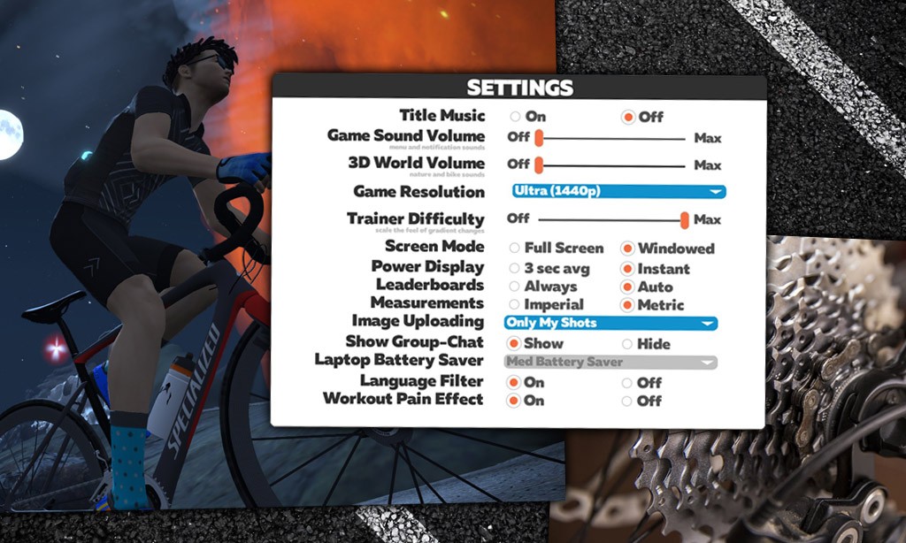

Interesssant finde die in dem Zusammenhang auch die Aussage von Eric/Zwiftinsider:
It may seem odd, but many Zwift racers turn Trainer Difficulty up for flat races, and down for climbing races. Why? Because they want the gearing flexibility of low Trainer Difficulty on long climbs, while high Trainer Difficulty lets them “feel” slight changes in gradient on flat routes such as Fuego Flats.
High Trainer Difficulty on flat routes makes even more sense if you’re racing a time trial, because it lets you feel those false flats and apply a bit more power to keep your speed high. Without having your Trainer Difficulty set high on a flat route, you may be on a slight incline and not even notice the difference – until you realize your speed has dropped by 2kph!
Überhaupt ist der ganze Artikel (vermutlich den meisten hier bekannt, ich verlinke es trotzdem) lesenswert:
