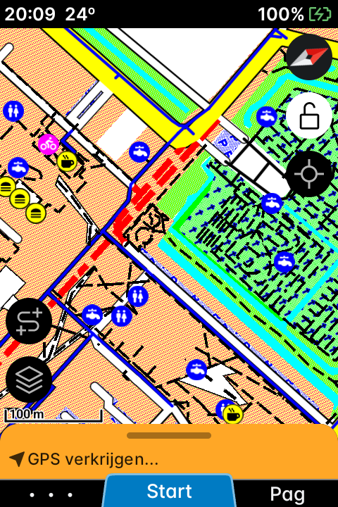

Piece of graveyard with water points and some of the university next to it:
Same area 200m scale:

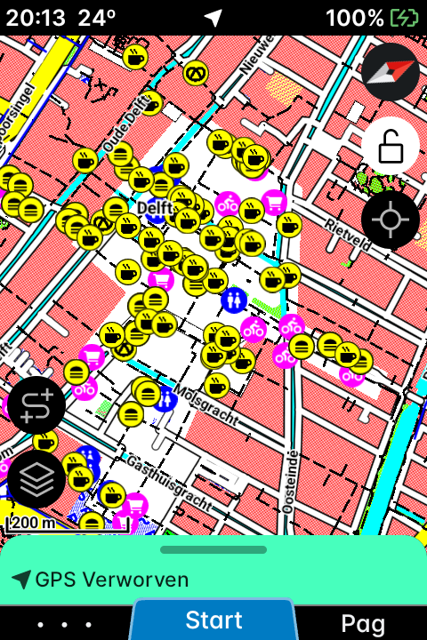

City center on a sunny day (bit crowdy ;-) ):
Market place. Apparently the theme does not show churches? There are two in this screenshot. Some people find churches great for orientation.

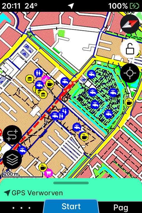

uhoh, no clue what the correct English words is, but a "childrensfarm" (?) playground with animals. An arboretum, camping, grassland and a piece park

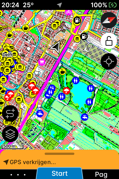

Larger area overview:
