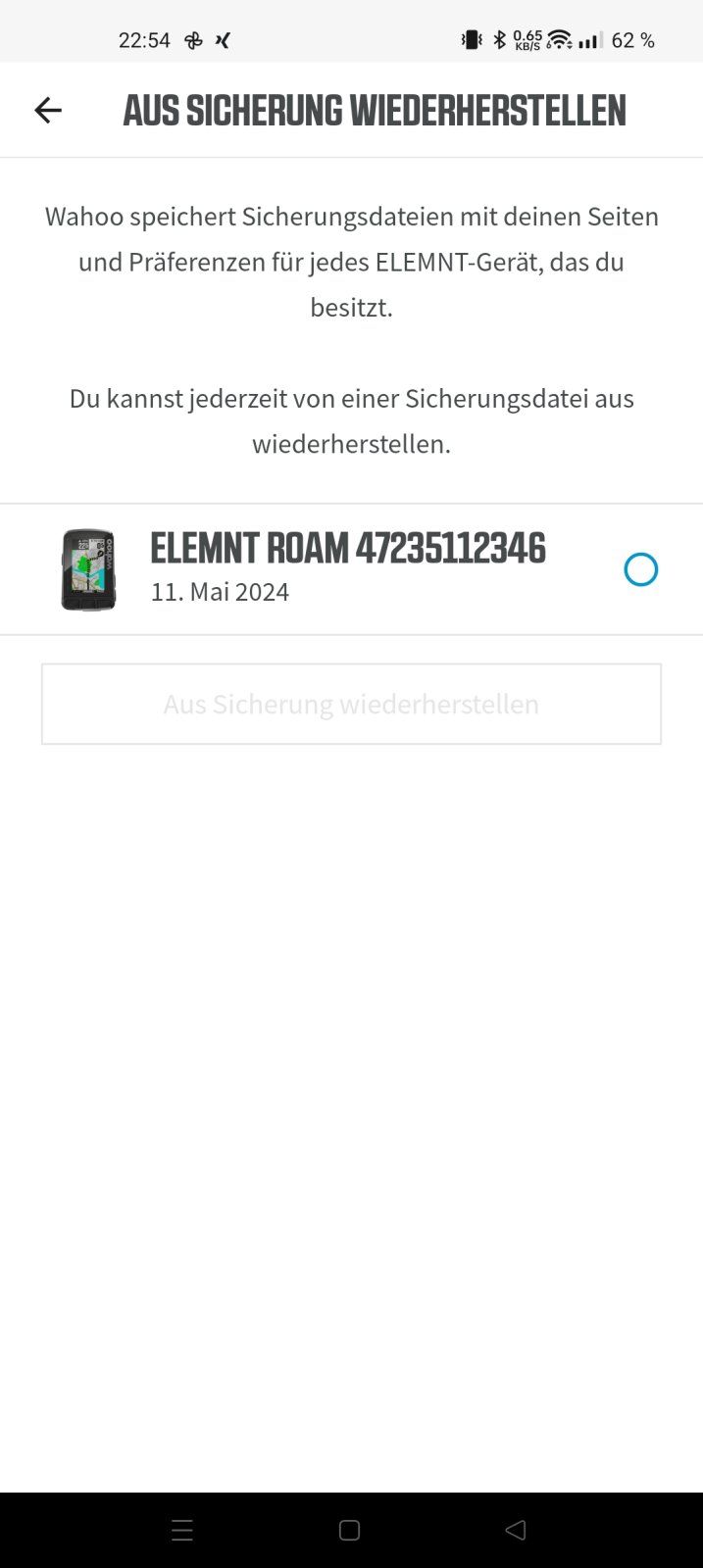

Hello Ebe66,
After long time Wahoo Support contact and many mails, the Support found the Solution.
My Roam V2 was a used device from Amazon (warehouse deal). So the device was initially registered to another user.
The device was connected to my account but was still owned by the the initially first user.
So the backup didn't appear on my Companion App.
The Support deleted the connection to the other first user and I had to connect/link the wahoo new to my account.
And surprise the backup was available!! Screenshot attached. And for luck, it was a old back from before factory reset. So all my old fine settings are back! I can't believe!! 🥳🥳🥳
Solved the problem with Pan and Zoom and with settings backup.
Never give up, keep on target 😉😬
Many thanks to all for you very professional and great help!

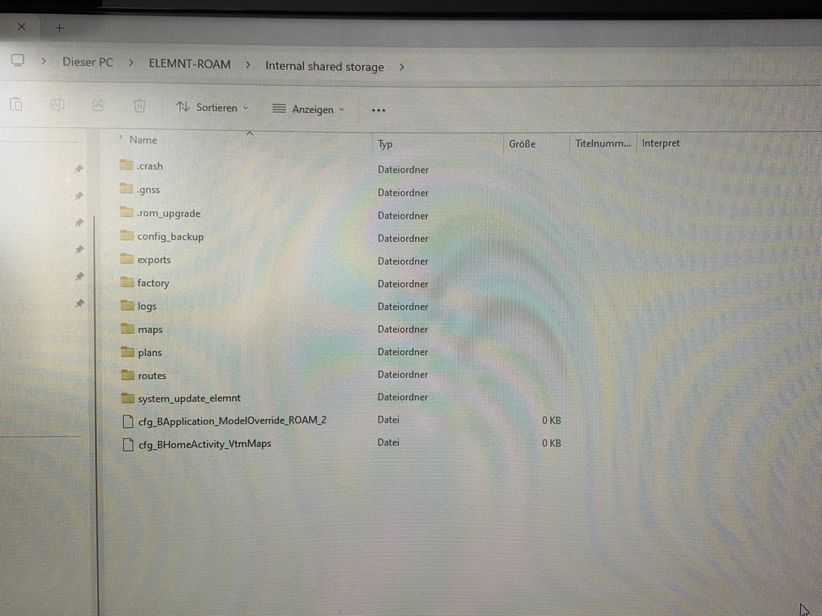

Hi all,
I have the same problem, did not realize that until today when reading the last posts.
In the Map Screen I have just „Routes“ on the left button but not dots. I already tried the workaround that worked for HerrRuin, but that did not work for me.
After creating the Model Override File I saw a difference in the booting screen (someting I would call colored confetti during the boot process), but I have still only the „Route“ button. Any other idea?
Edit: Found it! VTM rendering was active (not needed on the v2), that also forces the map screen behaving like a v1. After deleting that setting / file in in the home directory everything is fine.
I'll ask VTI (creator of Elemntary app to remove the pan & zoom option and put a warning by the vtm rendering option.
