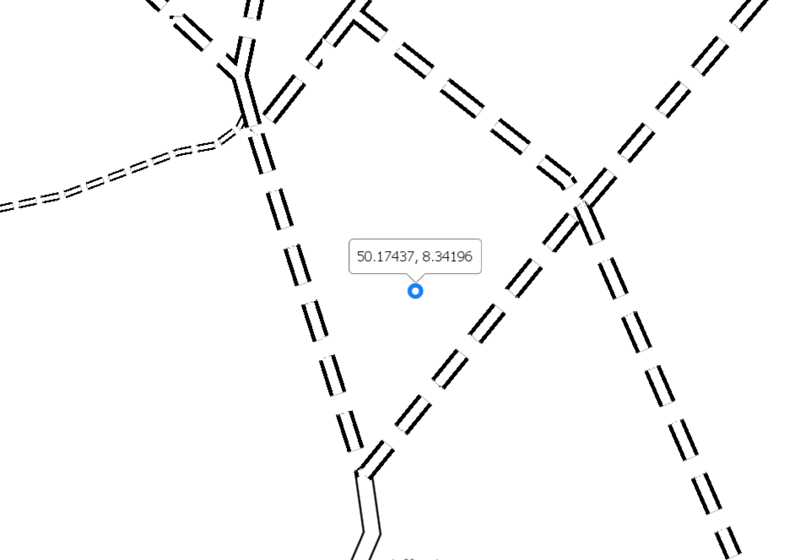

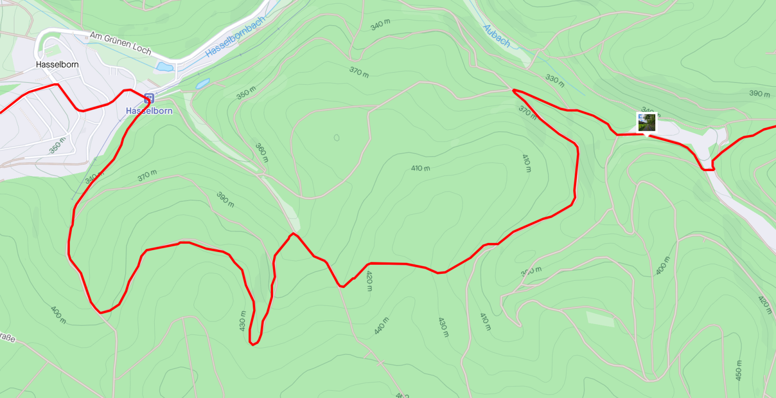

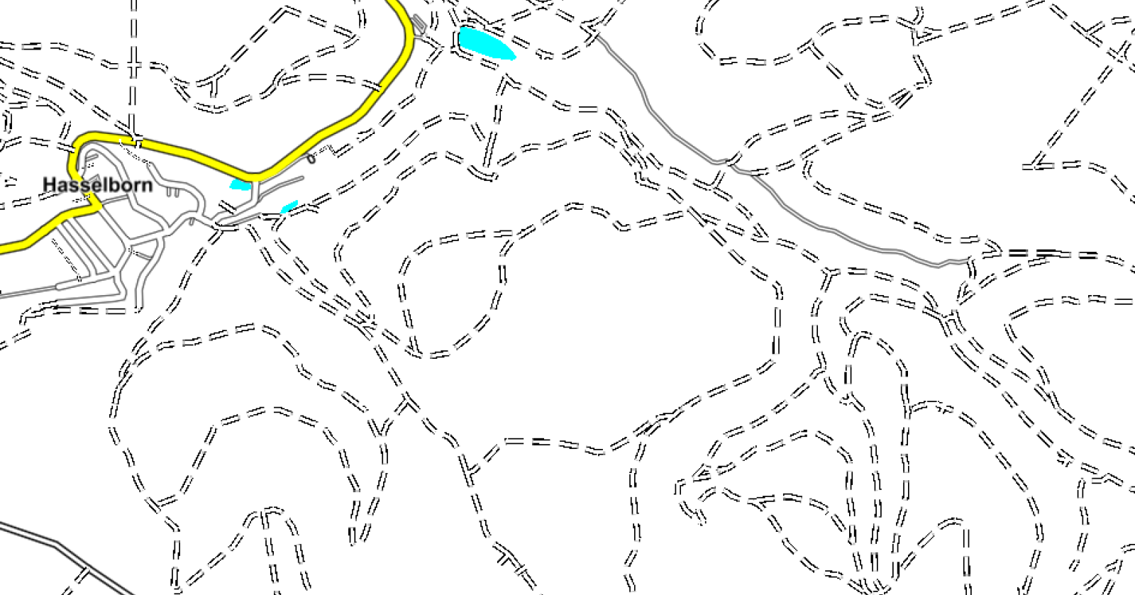

It might be the map files you use. I don't know what the problem area's are exactly but I followed from Monstadt to past Hasselborn and on my pc (with my self generated maps) I seem to be able to see all tracks. Below a part after Hasselborn.

Found it. The theme defaulted to the bolt2 so on my pc I saw the bolt version. When I switched to the roam I saw the tracks disappear. There was just one (I hope 😉) typo in the roam colors. Should be ok now I think.

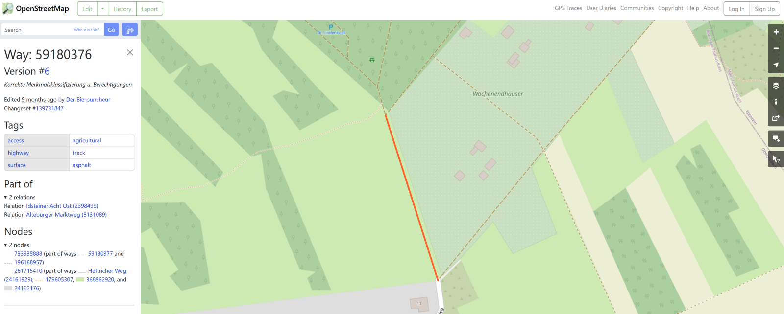

For future reference, if you go to the normal openstreetmap site at https://www.openstreetmap.org/way/59180376 you will find the options I described (pointer with questionmark icon on the right) and you (I) can see the roads properties:
ok, got it. I'll do that if I find another mistake and I can keep bugging you ;-)

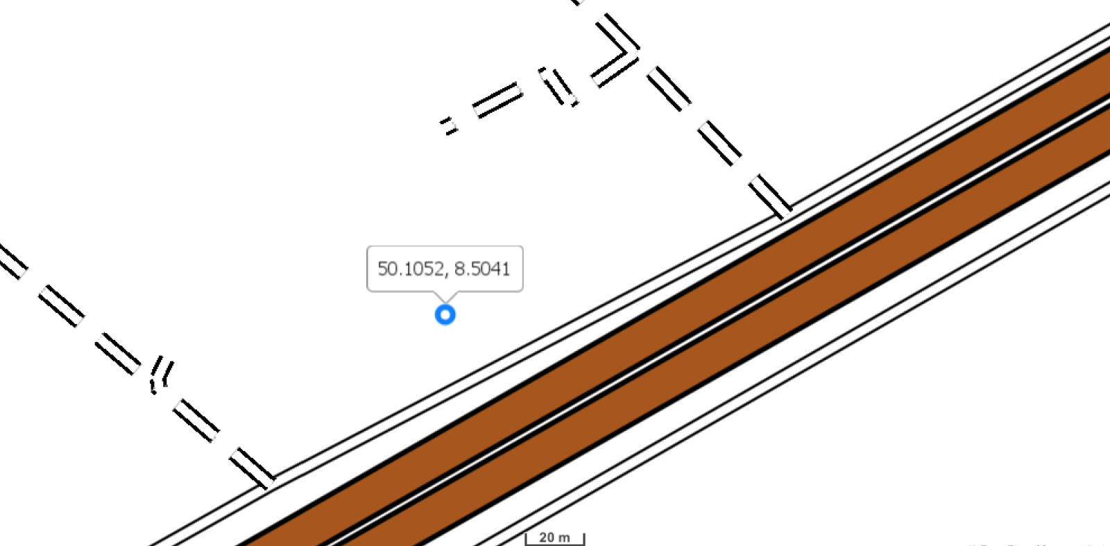

sorry, one more missing way (along a highway)
https://www.openstreetmap.org/way/4812046#map=15/50.1052/8.5041
Hate to ask, but are you sure? This is the same type of road with highway=service key/tag I fixed Wednesday.
It shows up for me on cruiser.

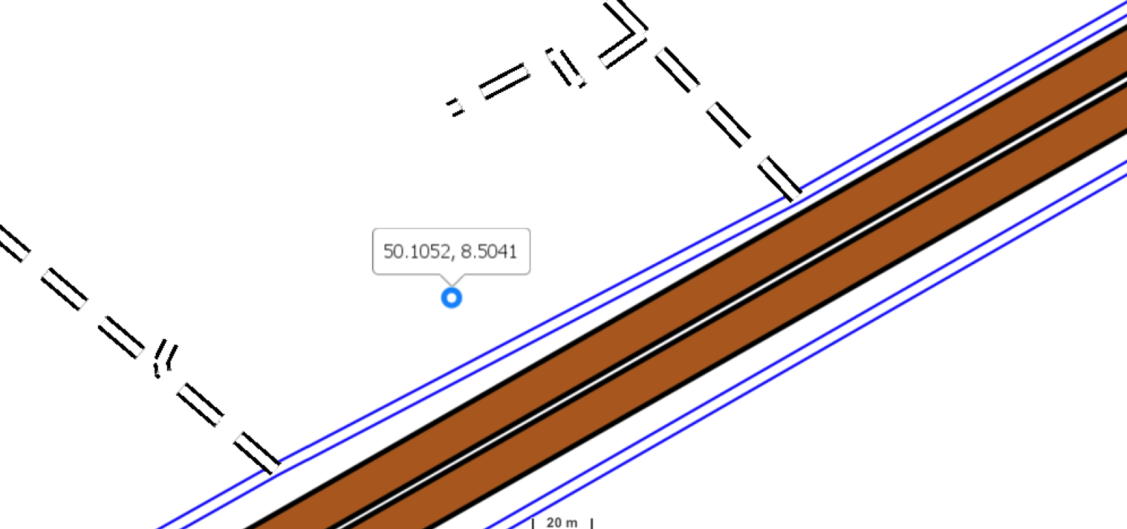

And I'm sure I'm looking at the right place in the theme because if I change the outline to blue I get this:
Line 234 in the theme file. It is also the only spot in the theme that matches the road conditions.
Can you maybe check that line with the theme on the device? It should read:
<line cat="roam2" stroke="#000000" width="1.5"/>
Where the 1.5 was wrong before (1.0).

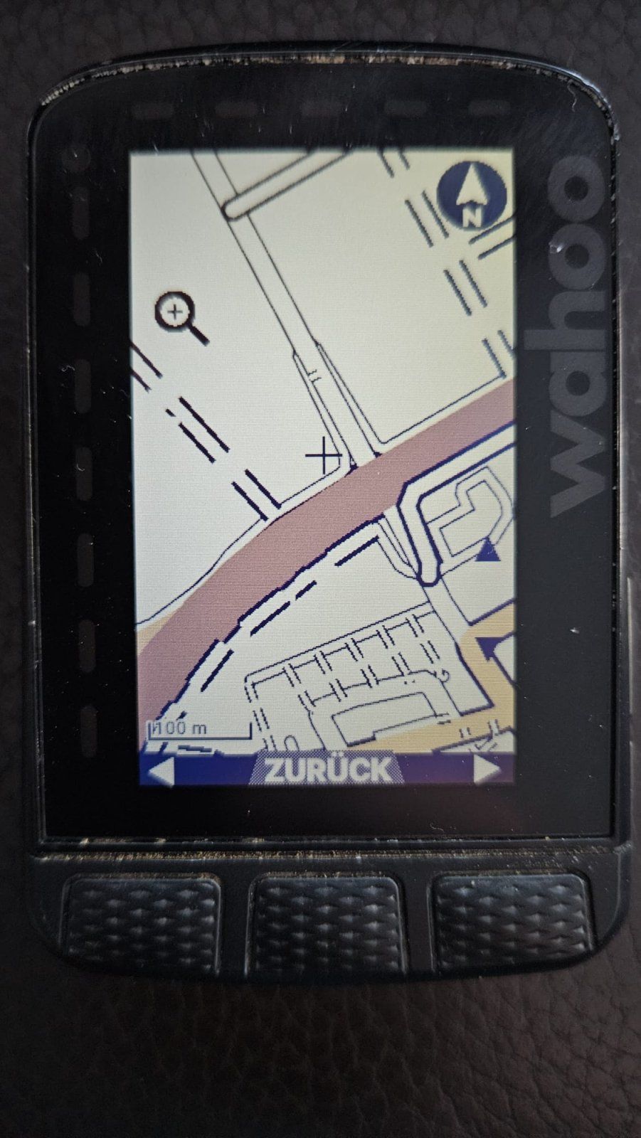

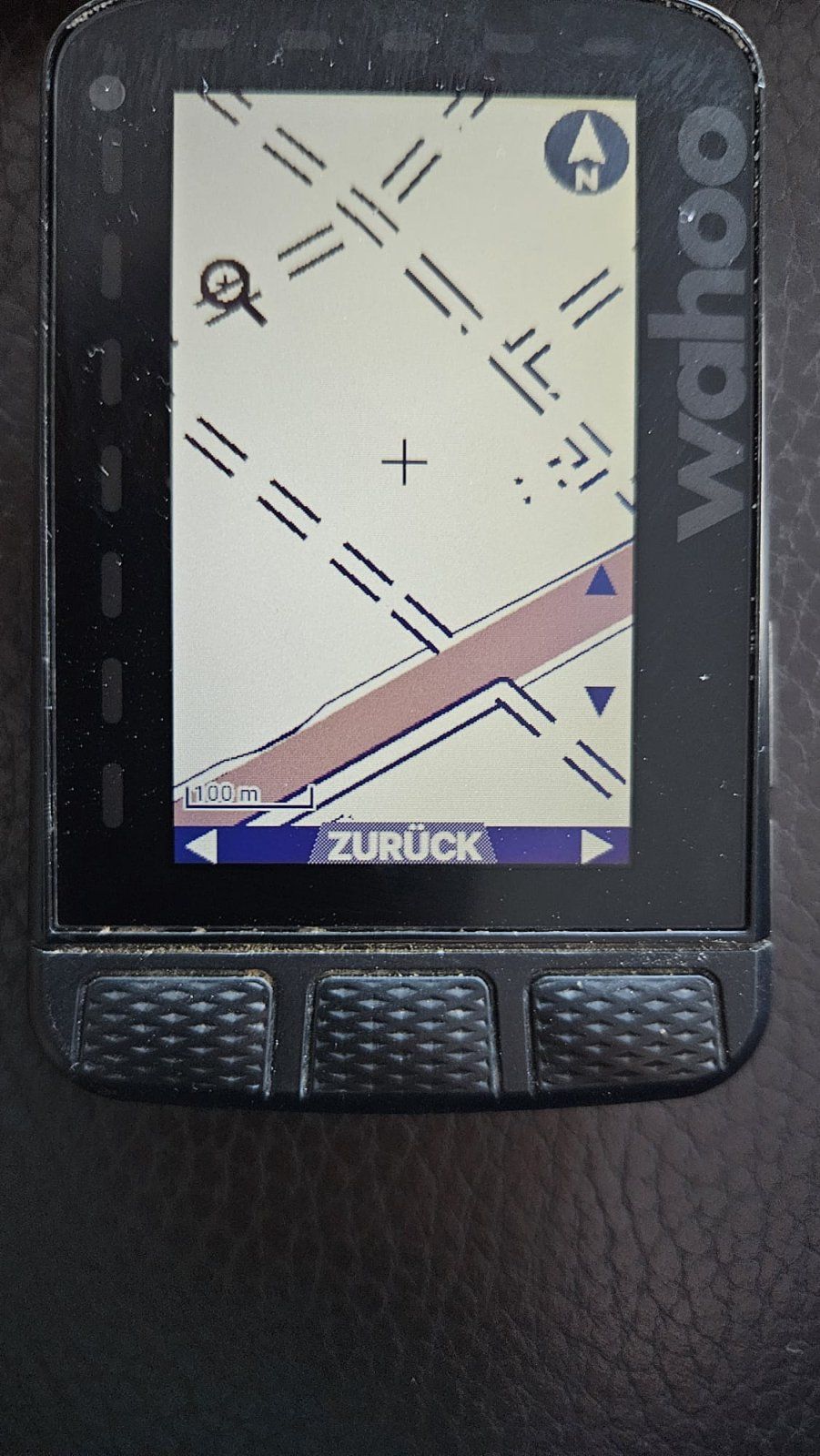

right! Your concerns are justified. Here is the same section on the Roam, where the path is shown as a fine line. Is that correct? In reality, the path is asphalted and approx. 4-5m wide.

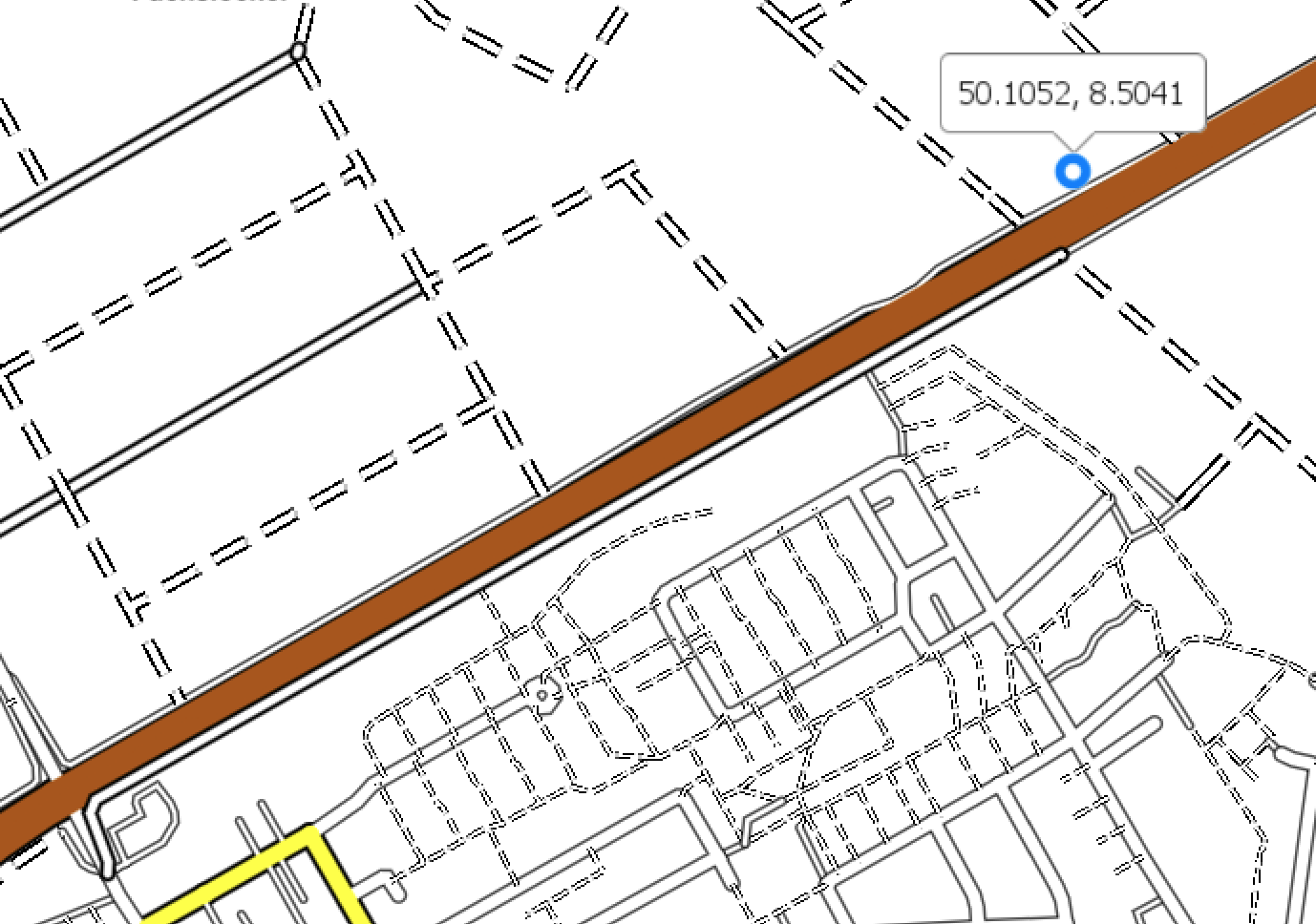

I think I see what is going on there. The road is actually shown, but you have to take into account the scale used and the limitations of the device (screen resolution). In your first screenshot you actually see the outer black line of the road, it's not part of the motorway. The inner outer line of your road is just overwritten/painted over by the motorway. If you zoom in more I'm sure you will see it. The actual physical width of the road does not matter here. As you see in the openstreetmap links you posted it is not an attribute of the actual road, so it can be 50cm or 50 meters wide, the way it is drawn would not change.
If I zoom out a bit on cruiser you get the same effect on a computer:
In your case you could change it by changing the line width of the motorway in line 299
<line cat="roam2" outline="roam2-major-roads" stroke="#AA5500" width="3.5"/>
From Wahoo's 3.5 to lets say 1.5. That makes it look like this on cruiser at the same scale:
But there pretty much always will be places/zoom levels where this happens.
As an example in your screenshots you can see that the road on the underside of the motorway is partly drawn on top of the motorway. I doubt it is so in reality.
That is caused by 1- The width of roads not being in openstreetmap 2- The theme being processed top to bottom. That is why themes (line 140 here) start with drawing sea then, so on top of sea, land then water etc. Your highway=service road is drawn in the block starting at line 230 and it is subsequently partly painted over by the motorway in line 299. So another "solution" could be cutting the highway=service part and putting it below the motorway part. But then it would still be touching the motorway.
Hope it makes some sense.
