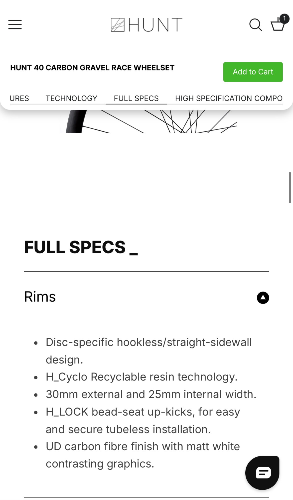

Welche Laufräder sind das nun? Mit 22mm innenweite?
H-lock … was auch immer das sein soll 🤷🏻‍♂️
Super, gleich im falschen Link von Micha0707 nachgeschaut...
Gravel doch hookless
Rims
Disc-specific hookless/straight-sidewall design. H_Cyclo Recyclable resin technology. 30mm external and 25mm internal width. H_LOCK bead-seat up-kicks, for easy and secure tubeless installation. UD carbon fibre finish with matt white contrasting graphics.
  • Disc-specific hookless/straight-sidewall design.
  • H_Cyclo Recyclable resin technology.
  • 30mm external and 25mm internal width.
  • H_LOCK bead-seat up-kicks, for easy and secure tubeless installation.
  • UD carbon fibre finish with matt white contrasting graphics.
H_Lock schaut so aus:
