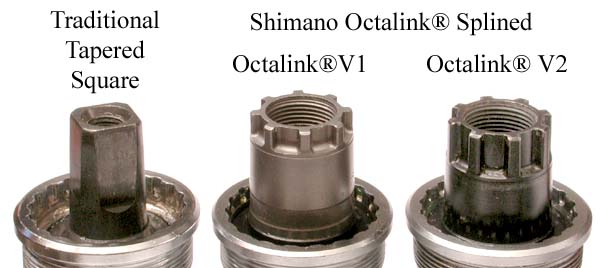

Das ist nicht ganz korrekt. Es gibt/gab 2 verschiedene Octalink Versionen von Shimano, V1 und V2.
SheldonBrown.com :
Octalink ® cranks come in one of two different spline patterns:
The original "V1 " type for:
XTR (BB-M952 9-speed)
Dura-Ace (BB-7700 9speed)
Ultegra (BB-6500 9-speed)
105 (BB-5500 9-speed)
The later "V2" type for:
Deore XT (ES70/71)
Deore LX (ES70/71)
Deore (ES50/51)
The V2 BBs work with FC M752, FC M751, FC M572, FC M571, FC M510-8 and FC M440-8 cranks.
Tiagra 2005 (4401,4404)
Sora 2005 (3301,3304)
http://www.sheldonbrown.com/gloss_n-o.html#octalink
