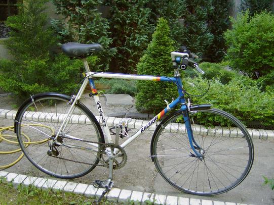

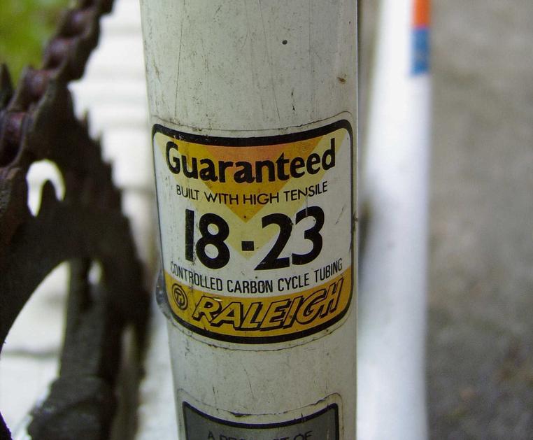

Also ich habe mal ein billiges 1987er Raleigh zerlegt (siehe anhängende Bilder - das würde ich übrigens Wasserrohr nennen, ohne Wenn und Aber ...), und das hatte definitiv Lagerschalen im proprietären Raleigh-Maß 1 3/8" X 26 tpi (@RadfreundHamburg: wenn dieses Kürzel - oder jedenfalls '26' statt '24' auf einer der Lagerschalen steht, würde ich vom Kauf abraten). Dass es parallel auch Raleigh-gelabelte Fahrräder mit normalem BSA-/BSC-Gewinde gab, erhellt aus Sheldon Browns Beschreibung (http://www.sheldonbrown.com/raleigh26.html , Abschnitt "Raleigh Threading"):
"The Raleigh bicycle company is one of the oldest in existence, going back to the early years of the 20th century. Back then, screw threads and other dimensions were not standardized to the same extent that they are now. Each manufacturer would develop its own proprietary "standards." Over time, this caused so much confusion and difficulty that a gradual movement toward industry-wide (or at least nation-wide) standardization. In Great Britain, most of the builders wound up standardizing on the dimensions used by B.S.A. (Birmingham Small Arms), an important bicycle and firearms maker in the early 20th century. Indeed, the B.S.A. standards became adopted as the "B.S.C." (British Standard Cycle) dimensions, and ultimately formed the hear of the ISO International standard in use today.
At the time of this transition, Raleigh was the Microsoft of the bicycle industry, and did not choose to go along with the adoption of B.S.A./B.S.C. standards. Right through the 1990s, the bikes built at the mighty Nottingham Factory were made to Raleigh proprietary dimensions. Since Raleigh made virtually every part of these bikes, there was no compelling need for them to match standards used by other manucacturers. (We shouldn't be too hard on them about this. Making the change would have been very, very costly, and wouldn't have benefitted the shareholders in any way.)
The main difference is that most screw threads in B.S.C./ISO have a pitch of 24 threads per inch (TPI), while the corresponding Raleigh parts have a slightly finer 26 TPI threading."
Daraus folgt meiner Meinung nach, dass wahrscheinlich die höherwertigen Rahmen der Marke Raleigh, die eben nicht im Stammwerk hergestellt worden sind, sondern z.B. bei Carlton in Worksop (bis 1981) oder in der Rennabteilung, in der Regel BSA-/BSC-Gewinde haben, während die "echten" (oder auch: eher schlechten ...) Raleighs das proprietäre Raleigh-Gewinde haben. Bei diesem Rahmen hier müßte man zumindest schauen, in welche "Abteilung" er gehört, da der Rohrsatz gut, aber nicht außergewöhnlich hochwertig ist.
Deine Anmerkung bezgl. des Rohrsatzes stimmt wohl, ein wirklich guter Rohrsatz ist das aber sicherlich nicht.
Na, aber was ist denn letztlich ein "wirklich guter Rohrsatz" ? Läßt Du da nur welche mit "großem Namen" gelten, und solche, mit denen seinerzeit Profis die Tour de France gefahren sind ? Da würde ich nicht mitgehen, denn wie fachkundige Forumsmitglieder (hier oder in der Parallelwelt) in anderen Threads schon klargestellt haben, erhöht sich die Brauchbarkeit eines Rohrsatzes ab einem gewissen Level nicht mehr, es sinkt allenfalls noch das Gewicht (in einem Bereich, der für uns "Normalradler" völlig irrelevant ist, also vielleicht 200 Gramm oder so), dafür steigt dann z.B. die Korrosionsanfälligkeit, und die Empfindlichkeit gegen das Einbeulen - das sind Dinge, die aus meiner Sicht einen Rohrsatz für ein tatsächlich im Alltag gefahrenes Rad sogar weniger gut geeignet machen. Ich bin wirklich der Meinung, dass so etwas wie der Bridgestone-Rohrsatz - kalt gezogener nahtloser CroMo 4130-Stahl, dreifach konifiziert - bereits das Optimum an Belastbarkeit, Steifigkeit, Dauerhaftigkeit und leichtem Gewicht für ein Alltagsrad darstellt. Und dass das entsprechende Bapperli nicht so toll klingt wie "Reynolds 531", halte ich für einen weiteren Vorteil - nämlich für eine (gewisse) Diebstahlssicherung ... :cool: Bei einem Sammlerrad wäre die Frage nach dem Rohrsatz sicherlich relevanter, auch, was den Preis angeht. Im Gebrauchtfahrrad-Markt spielt es wohl kaum eine Rolle (oder wenn, dann eher zu Ungunsten des Kaufinteressenten).
