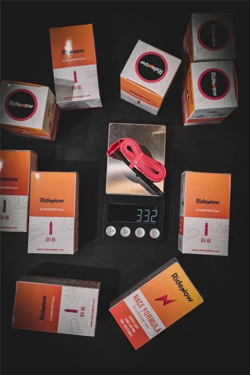

RideNow Race Formula wiegen bei mir 33g
https://www.bicyclerollingresistance.com/specials/tpu-inner-tubes
https://www.aliexpress.com/item/1005004071760931.html
