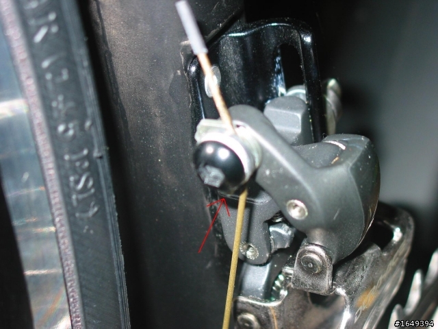

"FD-7900 has a longer linkage than other Shimano FDs(FD-6700,5700,7800… basically all FD before the 11s groups, which have long upper arms like FD-9000), therefore it must be used with ST-7900 to operate properly.
There's a solution though. If you put a tab washer(the type of washer on rear derailleur's cable fixing bolt) under the FD-7900's bolt, than route the cable below the tab and bolt, the effective lever arm length is reduced to be compatible with Sram shifter. Here's the example I used on one of my bike, the red arrow points to the tab of added washer:
After this mod, FD-7900 wil index correctly with Sram shifters, as other short-armed Shimano FDs do.
I don't use this setup anymore, IIRC, the shiftng feels similar to FD-5600(normal short-arm). I'm curious whether FD-9000/6800/5800 will work with Sram shifter, but I'm more inclined to use Sram 11s FD with yaw features, which should give the best results.Hope this helps."
