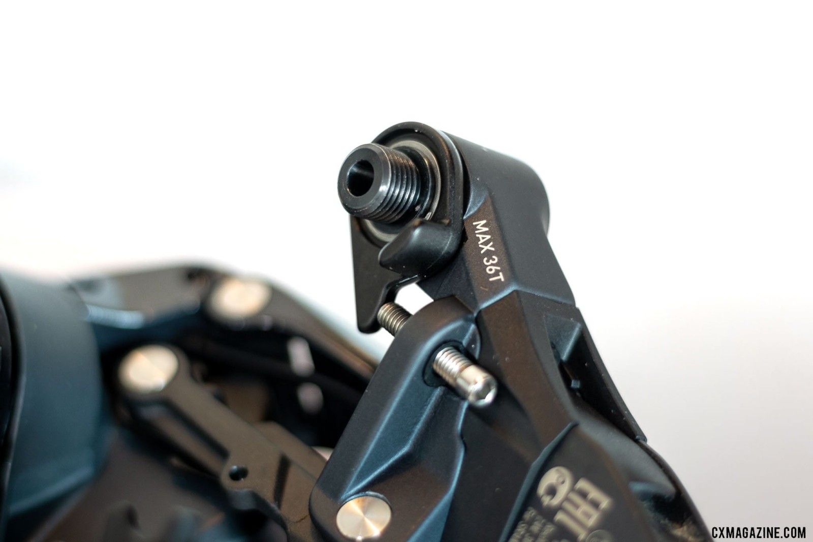

Wenn das "aktuelle" Force D1 Schaltwerk hast ja.
Max. Ritzelgröße hinten steht auf dem Schaltwerk. Das 36T Schaltwerk (für die 10-36 Kassette) hat ne Kapazität von 39 Zähnen, also Differenz vorne + Differenz hinten (48-35) + (36-10) = 13 + 26 = 39T. Vorne 50-37 Kurbel würde also auch gehen.

Force eTap AXS Rear Derailleur​
NEW 36t max version, RD-FRC-E-D1
Whether you ride 2x or 1x, tarmac or gravel, the new SRAM Force eTap AXS 36t max rear derailleur is made to take you further. Its additional low range cassette compatibility is complemented by Orbit damper technology for quiet, secure chain management over rough roads. It also capitalizes on large X-SYNC bearing-equipped pulleys for outstanding durability and efficiency.
  • Compatible with all 2x and 1x eTap AXS crankset and chainring options
  • Max 36t derailleur is compatible with 10-36, 10-33, and 10-28t cassettes
  • Orbit chain management technology keeps the drivetrain quiet and secure
  • SRAM AXS enabled, allowing easy control personalization
  • Large X-SYNC pulleys for durability and efficiency
  • Compatible with existing eTap batteries
What is the total drivetrain tooth capacity of the Force eTap AXS 36t-max rear derailleur?
Drivetrain tooth capacity for Force eTap AXS 36t-max rear derailleurs is 39t. (Drivetrain tooth capacity is calculated using the following formula: [difference between tooth numbers on
smallest and largest chainring] + [difference between tooth numbers on smallest and largest cog on cassette]).
What 2x chainring options are compatible with the Force eTap AXS 36t-max rear derailleur?
All of them: 43/30, 46/33, 48/35, 50/37.
