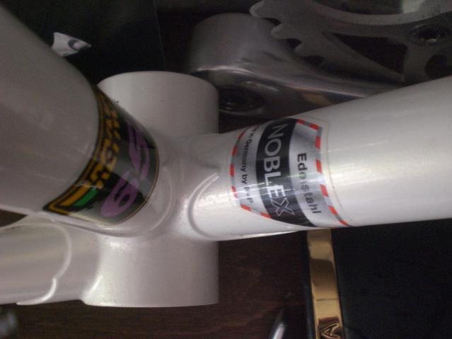

Von meiner Gazelle die Decals:

AW: Gazelle Gold Line Reynolds 653 Noblex
"Noblex Edelstahl [stainless] is as far as I can find out a type of stainless steel which was produced, among others, by a German tubing manufacturer called Potte & Pothoff. Their line-up included mostly if not only bicycle frame tubing. On this, the Exception the stays and fork blades are Noblex, while the rest is oversized Reynolds 731."
via:http://fivenineclimber.com/bikes/gazelle/other_frames/noblex.htm
Dieser Text bezieht sich auf das "Exception" Model. Reynolds 753 und Noblex

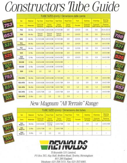

Vieleicht kanns nochmal einer Bestätigen. So wie es aussieht ist 653er Reynolds eine Weiterentwicklung vom 531 (c). Gabel und Streben sind bei meinem Gold Line definitiv Noblex.
Was wurde nun weiter entwickelt ich gehmal die Zahlen gugen:
attachment.php
"653 - Following feedback from Eddy Merckx that a pure 753 frame was too harsh for certain stages of the Tour de France[dubious – discuss], Reynolds produced a 653 tubeset which combined 753 stays with 531 main tubes and forks[dubious – discuss]. The 531 used was a thinner gauge than usual produced specifically for use in the 653 set[dubious – discuss]. Eddy and other riders were very pleased with the result[dubious – discuss], which combined a light, ultra-stiff and efficient transmission with a more forgiving and comfy ride"
via:http://en.wikipedia.org/wiki/Reynolds_Cycle_Technology
".I take it you mean the 753 reverts to 653 !
The key thing to remember here is that the 653 and 753 tube-set is the same tube-set. They have exactly the same gauges. If you order a 753 and a 653 tube-sets you get identical tubing.
The only difference between them is the final heat treatment.
653 is heat treated which makes it much stronger than 531C it is also much lighter because the tubes are thinner
753 is simply the process of a special heat treatment that gives it a little more strength than 653.
In order for Reynolds to maintain a standard of excellence over their premieire tube-set they insist that builders are licensed. Reynolds send you a tube-set which when built is returned to their labs for testing.
If it passes you are registered as a 753 builder and can purchase the 653/753 tube-sets and the 753 decals."
via:http://www.bikeradar.com/road/forums/viewtopic.php?t=12576404

Nochmal zum 653. Wenn man in die Zeittabelle der verschiedenen Rohre guckt, dann fällt auf, dass der von 1986 bis 1995 angebotene 653 aus dem 531P hervorgeht (mit 753er Hinterbau), der von 1981 bis 1986 angeboten wurde. Dieser wiederum ist eine Neubezeichnung des 531SL, der von 1978 bis 1981 angeboten wurde. Zu diesem Rohrsatz wiederum steht in der Tabelle, dass er dünnere Rohre hat als der 531C.
Folglich ist 1978 der dünnwandige 531SL herausgekommen, welcher 1981 in 531P und dann 1986 in 653 umbenannt wurde. Aus welchem Material der Hinterbau ist, ist ziemlich kolbasa, denn der Rahmen ist ja aus dem dünnwandigen 531, welches ja jetzt 653 heißt.
"It is so long ago that we supplied Gazelle, we would no longer have the
records.
Have you asked Gazelle ?
If it was 653, then the 3 main tubes were 531 drawn thinner, and the rear
stays 725
Terry"
via: Reynolds Tubing
