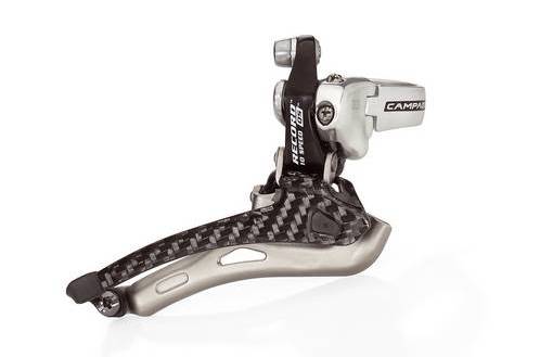

New Record and Chorus front derailleurs
The Record and Chorus front derailleurs have been completely redesigned. The new 2008 range versions have a standardized fork, compatible both with standard and compact cranksets, and new body and inner plate designs which provide a marked improvement in shifting performance.
Front derailleur body: The new body has been designed to embrace the two plates, the inner one and the front one. As a result the system is much more rigid and produces higher shifting performance, especially when shifting up with force from the smallest sprocket to the largest, i.e. at the most critical moment.
Front derailleur fork: the new fork design was developed to function perfectly with both standard and CT Campagnolo cranksets. The new fork retains the front part of the previous CT front derailleur, in other words the part that couples the chain at the moment of shifting towards the largest sprocket. But the rest of the fork is new. The curving and height of the fork are the fruit of laboratory testing which made it possible to establish a perfectly effective form in the case of both standard and compact sprockets.
Front derailleur inner plate: the new inner plate is overturned and pulled back compared with the previous one. This solution improves chain thrust when shifting towards the largest sprocket. Now the point at which the plate pushes on the front derailleur is in the middle part of the fork and no longer at the front. The result is a greater force applied to the fork and an increase in the rigidity of the whole.
Centaur, Veloce and Mirage front derailleurs
The front derailleurs of the Centaur, Veloce and Mirage groupsets adopt the new standardized fork for Standard and Compact cranksets.

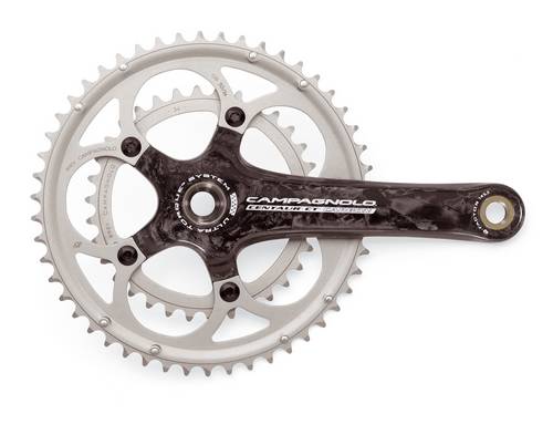

Centaur Carbon crankset
The Centaur groupset will have an Ultra-Torque Carbon crankset option. The Centaur groupset, which with its technology and technical solutions is in no way inferior to competition groupsets, offers the Ultra-Torque carbon fibre crankset option in the 2008 range. Campagnolo therefore continues the march begun last year to bring the distinctive technological pluses of its top range to the middle range too: Ultra-Torque crankset, Skeleton brakes and carbon fibre. All of this, obviously, at a more reasonable price.
TECHNICAL SHEET
Cranks: multidirectional carbon fibre with unidirectional carbon fibre structure
Sprockets: aluminium
Screws: steel
Toothing: 53/39 – 50/34
Lengths: 170 – 172.5 - 175
Weight: 756 grams

Neue Umwerfer für Record und Chorus
Die Umwerfer für die Gruppen Record und Chorus wurden komplett überarbeitet. Die neuen Versionen im Angebot 2008 besitzen ein einheitliches Leitblech, sind sowohl mit Standard- als auch mit Compact-Kettenradgarnituren kompatibel und zeichnen sich durch ein neues Design an Umwerferkörper und innerer Schaltstange auf, wodurch sich die Umwerfleistung deutlich verbessert.
Umwerferkörper: Der neue Körper wurde so konstruiert, dass er beide Schaltstangen, die innere und die vordere, wie in einer Umarmung umfasst. Dadurch wird das System wesentlich steifer und erbringt einen deutlich leistungsfähigeren Umwerfvorgang, dies vor allem im besonders kritischen Moment, wenn am Berg unter Last vom kleinen auf das große Kettenblatt umgeschaltet werden muss.
Leitblech des Umwerfers: Das neue Design des Leitblechs wurde so entwickelt, dass es sowohl mit Standard- als auch mit CT-Kettenradgarnituren von Campagnolo bestens funktioniert. Bei dem neuen Leitblech kommt der vordere Teil des vorherigen CT-Umwerfers wieder zum Einsatz, das heißt also jener Teil, der die Aufgabe hat, die Kette beim Umwerfvorgang in das größere Kettenblatt einhängen zu lassen. Der Rest des Leitblechs ist dagegen komplett neu. Spezifische Formbiegung und Höhe des Leitblechs sind das Ergebnis gründlicher Labortests, aufgrund derer eine Form bestimmt werden konnte, die sowohl bei Standard- als auch bei Compact-Kettenradgarnituren voll effizient ist.
Innere Schaltstange des Umwerfers: Die neue innere Schaltstange ist im Vergleich zum vorhergehenden Modell umgekehrt und weiter zurückgesetzt angeordnet. Durch diese Lösung wird beim Umwerfvorgang die Schubwirkung der Kette zum größeren Kettenblatt hin verbessert. Denn jetzt befindet sich der Punkt, wo die Schaltstange auf den Umwerfer drückt, im mittleren und nicht mehr im vorderen Teil des Leitblechs. Dadurch kann mehr Kraft auf das Leitblech ausgeübt und eine größere Steifigkeit der gesamten Einheit erreicht werden.
Umwerfer für Centaur, Veloce und Mirage
Die Umwerfer für die Gruppen Centaur, Veloce und Mirage weisen alle das neue einheitliche Leitblech für Standard- und Compact-Kettenradgarnituren auf.
Centaur Karbon-Kettenradgarnitur
Die Centaur-Gruppe bietet in diesem Jahr eine Kettenradgarnitur aus Karbon-Faser als Option an.
Für das Angebot 2008 präsentiert die Centaur Gruppe, die bei Technologien und technischen Lösungen durchaus mit den Gruppen für den Wettkampfsport mithalten kann, als Option die Ultra-Torque Kettenradgarnitur aus Karbon-Faser.
Damit beschreitet Campagnolo weiterhin den im letzten Jahr eingeschlagenen Weg, auch den Gruppen der Mittelklasse die bereits für sein Spitzensegment kennzeichnenden technologischen und technischen Vorteile wie die Ultra-Torque Kettenradgarnitur, die Skeleton-Bremsen und Karbon-Faser als Material zukommen zu lassen. Das Ganze wird in dieser Klasse dann natürlich zu einem erschwinglicheren Preis geboten.
TECHNISCHE DATEN
Tretkurbeln: Multidirectional Carbon Fiber mit Struktur aus Unidirectional Carbon Fiber
Kettenblätter: Aluminium
Kettenblatt-Kombinationen: 53/39 – 50/34
Kubelarmlängen: 170 – 172,5 – 175 mm
Schrauben: Edelstahl
Gewicht: 756 g
Preis: 262 + IVA

anbei die passenden fotos... ;)
weitere Fotos...
