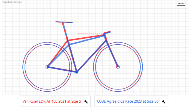

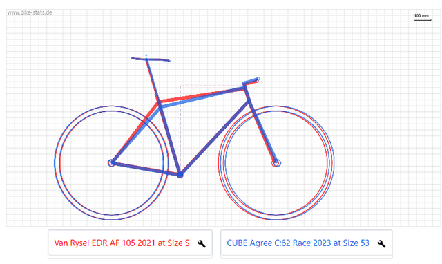

But I really need your help about the sizing of this bike...
So I thank anyone who could help me.
I choose this bike to replace my Van Rysel EDR AF105 which I had in S size.
I'm 1m71/1m72 tall and my leg size is arround 81cm.
My saddle height recommended (72cm)
With the Van Rysel I put a 80mm stem instead of the default 90mm to be more confortable and it works, but I still had the feeling that something missed, when I grab the brake lever hood I had the impression that I lacked 1cm or 2 to be perfectly comfortable in this position.
Here you can find a comparaison between the two bike: https://bikeinsights.com/compare?geometries=5f22c8135f0c920017fc3667,617c3ef4b431bd001caab090
Cube calculator indicate 53cm for my size.
But It seems, 50cm will more fit to my size with my feedback on the Van Rysel.
About the seatpost with the 50cm size:
I would have to extend the seatpost by about 28cm, so there would be 7cm left in the seat tube but I don't count the height of the saddle (5cm between the bottom of the rail and the seat), so more like 12cm in fact, that's 1/3 of the seat post retracted into the seat tube, so looks fine to me ?
What do you think, 50cm or 53cm ?
Sadly, I cannot test those bike to a dealer shop
Thank you very much.
